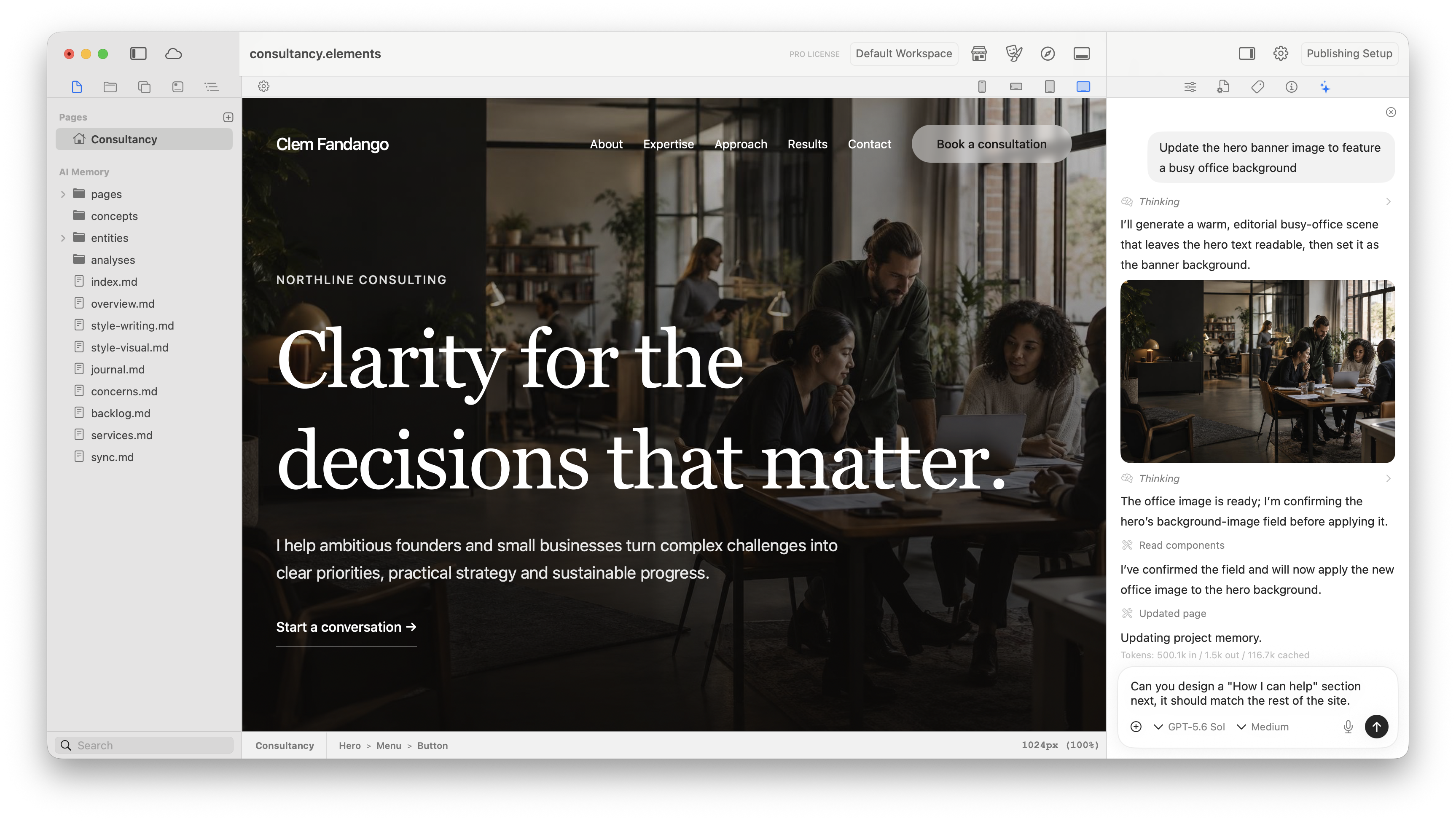

2. Click the **sparkles icon** in the tabs at the top of the right-hand inspector sidebar.
3. The **AI Assistant** opens in that sidebar. Enter your request in the message field at the bottom of the panel.
The model menu only shows models from providers whose API key you have added. Use the effort menu beside it to choose how much reasoning the model should apply. **Medium** is the default; lower settings suit quick, simple changes, while higher settings can help with more complex work but may take longer and use more tokens.
For example, you could ask it to create a banner for your business, refine the text on a page, or adjust a layout.
