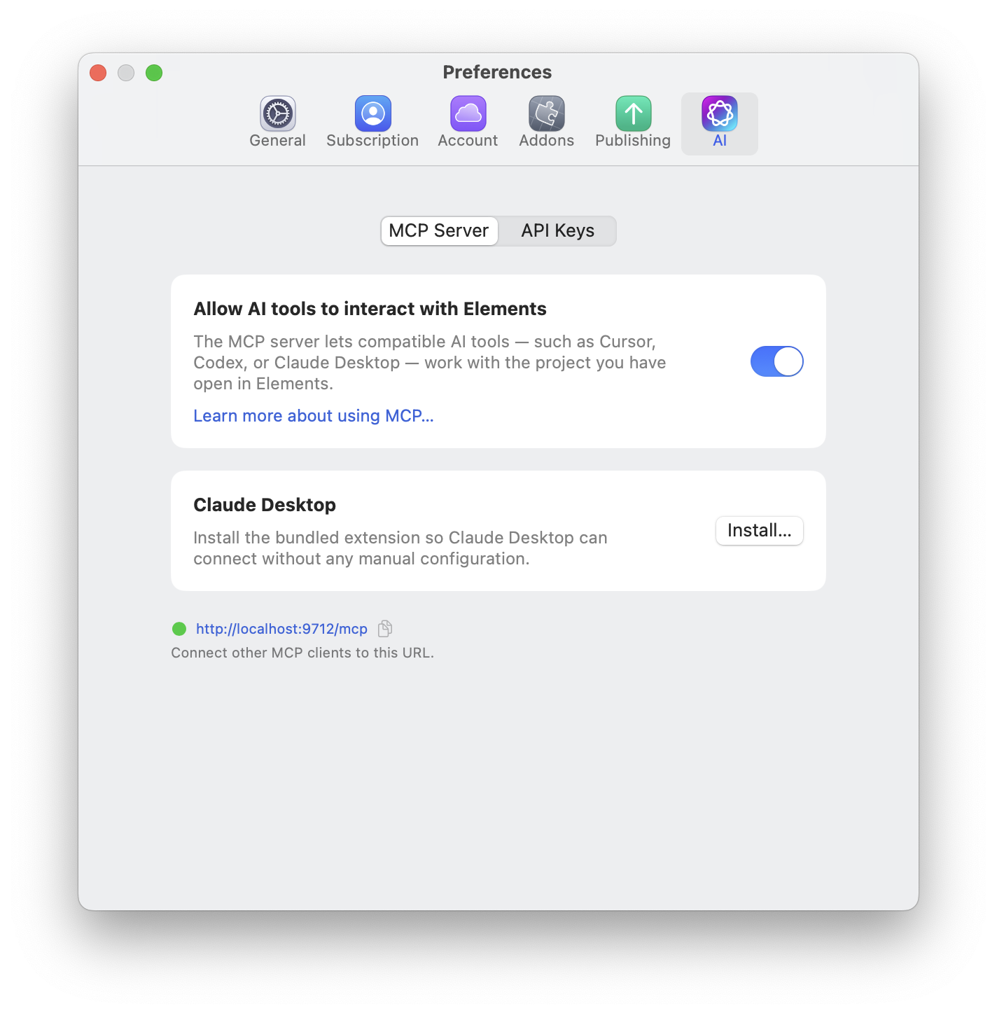

The full settings path is **Settings > AI > MCP Server**. The screenshot below shows the server enabled, with a green status indicator and the URL `http://localhost:9712/mcp`.
<figure><img src="https://3876014504-files.gitbook.io/~/files/v0/b/gitbook-x-prod.appspot.com/o/spaces%2FNy6AECEVH2p4eFDicpM1%2Fuploads%2Fgit-blob-a8116fb5131c8fd3976f12e95c932eb5c22ac7d3%2Felements-mcp-server-preferences.png?alt=media" alt="Elements Preferences showing AI > MCP Server, the enabled Allow AI tools to interact with Elements switch, the Claude Desktop installer, and the local connection URL"><figcaption><p>Enable the MCP server, install the Claude Desktop extension, or copy the local URL for another MCP client.</p></figcaption></figure>
